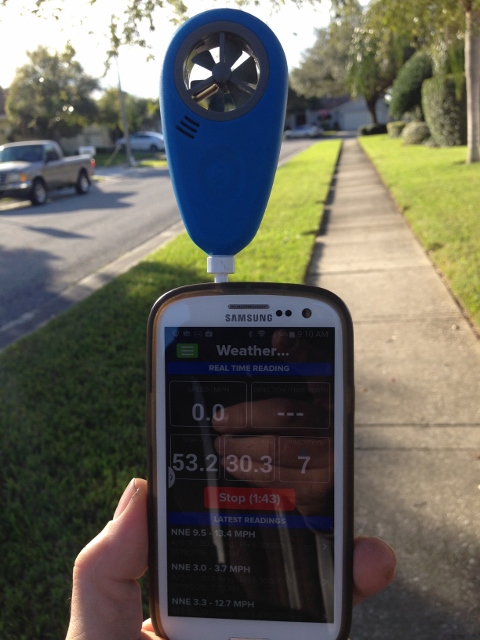

1. Double-check that you have the units properly set. For example, if you prefer mph or knots but have the Settings to m/s, winds will appear to report at roughly half of what you expect.

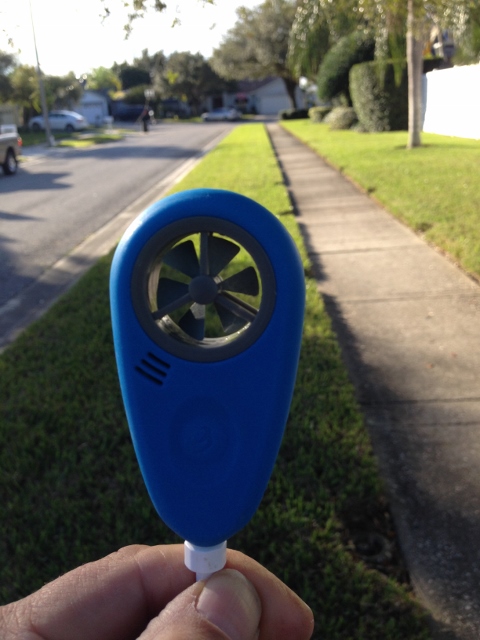

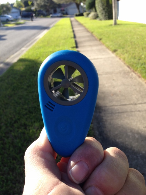

2. Ensure that you've oriented the Weather Meter correctly. The WEATHERmeter should point into the wind and should be held up as high as possible. Holding the device behind, in front of, or even next to your body or another large object can create wind shadowing that results in lower wind speeds being recorded.
3. Stand in an open, unobstructed area when taking readings. Standing next to a building or structure, beneath a tree, etc., could easily result in lower wind readings.

If using the meter's direction setting, the physical orientation of the meter into the wind will be important for accurate direction readings. Face into directly into the wind and hold the WEATHERmeter above your head with the logo facing you. If the wind direction changes over the sampling period, either end the reading or adjust the angle for an average direction over the duration of the sampling period.
