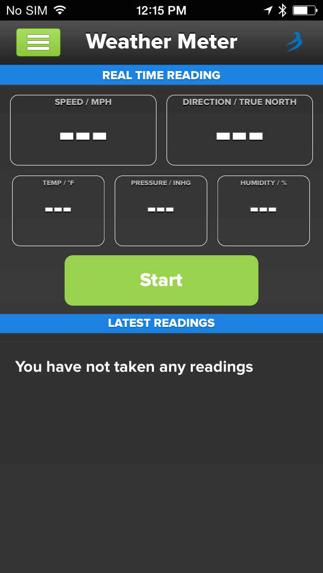

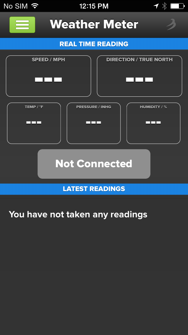

- Press the center button on the WEATHERmeter to power it on. You should see a faint blue LED on the device, it will go out once connected. If prompted with a "Not Connected" message, choose "Dismiss", then connect your Bluetooth WIND/WEATHERmeter.
- A Start button will appear indicating the WEATRHERmeter is connected and ready to stream observations to your device.

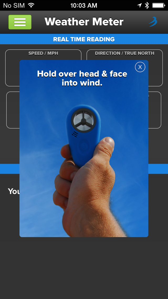

- Hold the WINDmeter or WEATHERmeter into the wind with the logo facing you.
- Press Start to begin a reading and press Stop to end the reading.

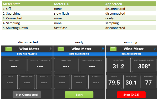

Meter Statuses
The LED patterns on the meter and the app screen icons together indicate five different states outlined in the table below:

The WEATHERmeter app is able to use the connected phone's compass heading for an accurate wind direction reading. If you are using your phone's compass for wind direction, remember you will need to also point the phone in the direction where the winds are coming from. Face directly into the wind and hold the WEATHERmeter above your head with the logo facing you. If the wind direction changes over the sampling period, either end the reading or adjust the angle for an average direction over the duration of the sampling period.
