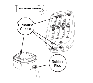

Using the included tube of dielectric grease, apply a small amount of grease to all exposed metal components in order to protect from corrosion due to moisture.
Included with the Power Booster is a rubber plug and a spare. Fit the plug over the flat cable and slide it into the wafer base. The plug only fits one way.

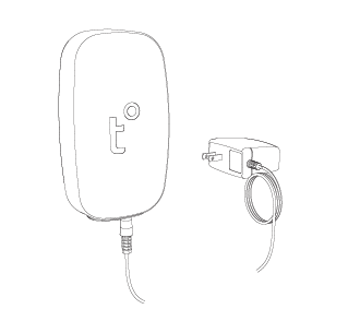

Using the power adapter: If installed outdoors, apply dielectric grease to the barrel connector where it attaches to the PBA. |

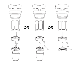

Remove the Tempest from its base and check the gold contacts on the bottom of the Tempest device (before the PBA is attached) for corrosion. You can use a pencil eraser to clean the contacts. Apply dielectric grease to the four gold pins on the wafer. Reboot the Tempest device: flip the power switch off for a moment and then back on. The LED should flash green and then go out, indicating it has reconnected to the Hub. Connect the upper component of the PBA (the “wafer”) between the Tempest device and the existing pole mount or flat base. Take care not to deform the four gold pins on the wafer. The cable can exit the wafer from the side. Secure the cable with zip ties. On newer pole mounts only, (circa April 2022), the cable can also be threaded through the middle after removing the built in level. |

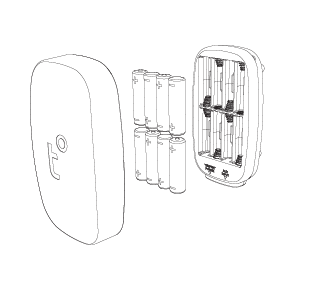

If using batteries, remove the cover and install up to eight (8) AA batteries into the lower component, taking care to orient the battery polarity correctly, as indicated in the battery holder. We recommend lithium primary cells (such as Energizer Ultimate Lithium), but standard alkaline batteries will also work in locations that do not regularly see sub-freezing temperatures. If installed outdoors, apply dielectric grease to the battery contacts before inserting the batteries. Note, rechargeable batteries are not recommended and the power adapter (wall power source) will not charge the batteries in the PBA. |

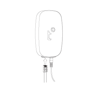

The power cable that connects the wafer to the lower component of the PBA is a weatherproof, 8-conductor flat network cable that plugs directly into the lower component. If installed outdoors, apply dielectric grease to the contacts inside the jack. |
