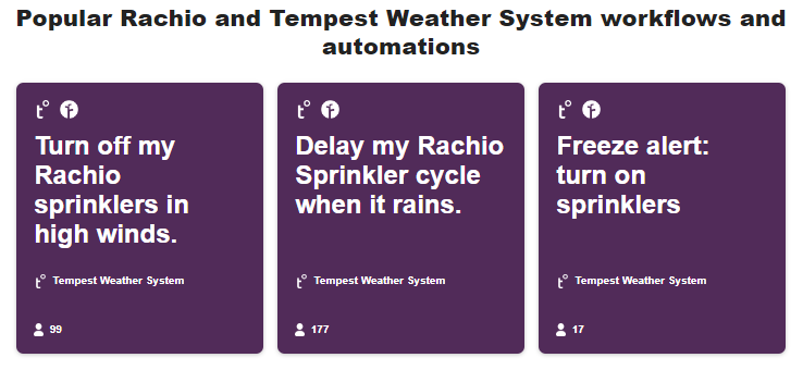

Integration through IFTTT
IFTTT (If This Then That) is a free and easy way to do more with data from your Tempest System. Link your Tempest account to IFTTT and use your weather data to trigger actions with your Rachio controller based on wind, rain and temperature measurements.
Visit the Tempest/Rachio IFTTT connection page to activate the rain delay, wind skip, freeze skip or freeze activate IFTTT applets. Or create your own applets using the ingredients and actions available in the Tempest & Rachio services! For example, set up a custom high temperature trigger for an extra watering cycle.
