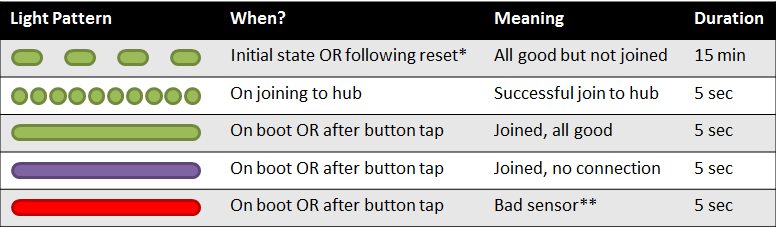

Tempest device not found
The Tempest device must be in pairing mode before connecting to the Hub. Pairing mode is indicated by a slow blinking green LED on the base of the unit.
- Remove the mounting attachment.
- On the base of the device, press and hold the clear button next to the power switch until the LED flashes.
- After a few seconds the LED will slowly blink green, indicating it is ready to pair to a Hub. Continue with the setup procedure in the app.
Additional device connection tips
If the LED on the base of the unit is not illuminating at all, there could be a low battery issue. Make sure the device is turned on and place it outdoors with the solar panels facing towards the sun. The Tempest device can charge sufficiently within a few hours. Check the LED again.
Station setup but no historical data
If your station is setup but you're not getting any historical data, then your outside Tempest device is likely not properly paired to your station. To check that, open the app and go to settings > stations > select your station > tap manage devices > if no device is listed then you'll need to add your device:
- Remove the mounting attachment on the bottom of the device.
- With the device powered on, press and hold the clear button next to the power switch until the LED flashes.
- Then add it to your station by going to settings > stations > select your station > tap manage devices > add device > the device will appear on screen, choose the device to finish connecting it.

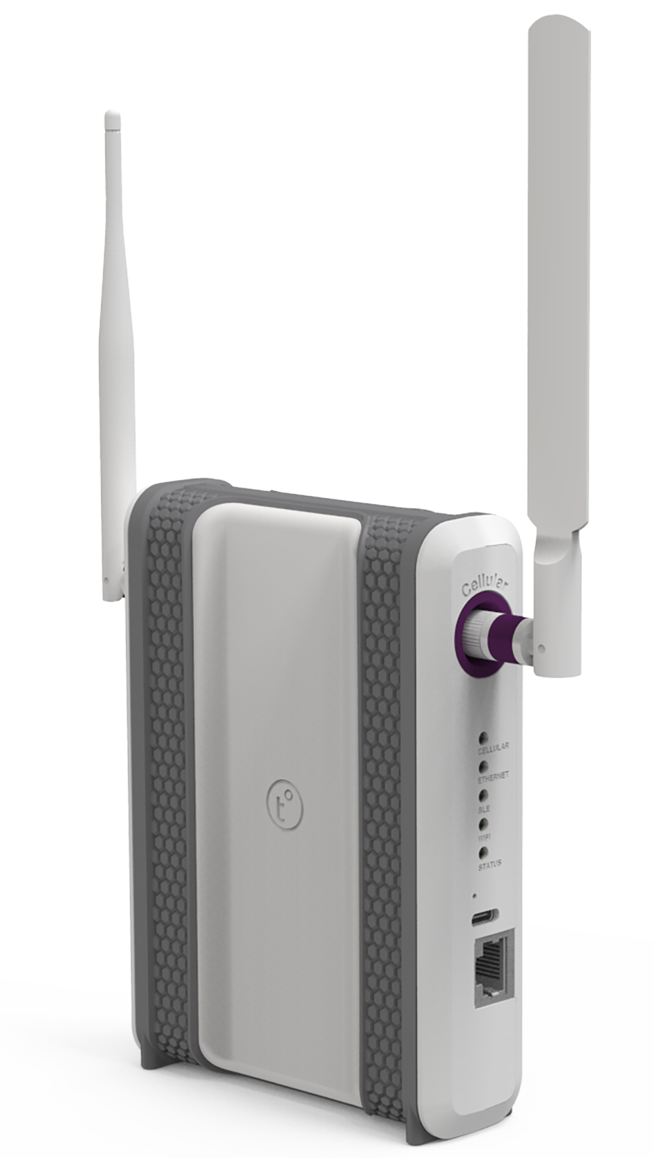

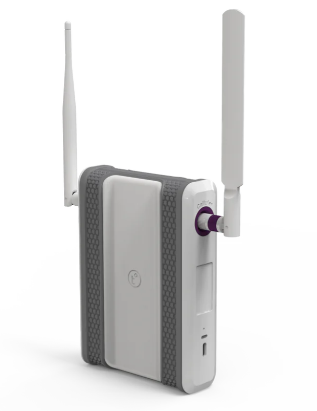

Cellular Connection Troubleshooting
Cellular network not found
- Make sure the cellular antenna is connected to the correct side, denoted by the purple coloring
- Check to make sure the Hub is plugged in and has power
Cellular data signal may be very weak
- Cellular Hub will not work everywhere
- If your phone's cellular strength is weak very likely the Hub's is too
The SIM card is certified for use in select countries
- You can't bring a North American cellular Hub to another country or vice versa.
Hub loses cellular connection - "Station offline"
Check the cell status field in the Tempest app: settings > stations > select your station > status > cell status.
A value closer to 0 is best:
Excellent: -10 < RSSI < 0
Good: -15 < RSSI ≤ -10
Fair: -20 < RSSI ≤ -15
No Signal: RSSI ≤ -20
Reboot the Hub.
- If the Hub is indoors, try moving it to a new location as well.
Re-do the cellular antenna connection.
- The antenna collar needs to be tight, but the antenna itself is able to spin freely.
Check the LED lights
- If cellular LED is not illuminated = not connected to cellular network
- If status LED is red or not illuminated = issue connecting to our servers
- If your Hub only has one LED - red = not connected to cellular network or our servers
If issues persist please contact us for further assistance.

Tempest device LED status indicators
The Tempest device's LED will not stay illuminated, even when it has power. To activate the LED status indicator, press the LED button on the base of the unit next to the power switch.
Red LED: The device may have a non-responsive sensor. This status supersedes all other device statuses.
If you're seeing a failed sensor status in the app or a red LED on the device itself, please check the Tempest device troubleshooting steps above. If you cannot resolve the issue, please contact us for assistance. Do not delete the device from your station.
Purple LED: The device has not successfully paired to a Hub.
If you see a purple LED, the device needs to be reset the device reconnected to the station Hub.
- Remove the mounting attachment from the Tempest device.
- On the base of the device, press and hold the translucent button next to the power switch until the LED flashes.
Open the app, go to settings > stations > (select your station) > manage devices > tap “+” to add the device to the station Hub > select the serial number on screen to finish connecting the device.
Note: If you are instead replacing a device on your station - after resetting the unit go to Settings > Stations > (choose your station) > Manage Devices > (select the device you are replacing) > Advanced > Replace Device > follow the remaining steps in the app to connect the new device.
Slow blinking green LED: The device is in pairing mode.
If you have not connected the Tempest device to your station Hub yet, then you will want to add it as a new device:
- Open the app, go to settings > stations > (select your station) > manage devices > tap “+” to add the device to the station Hub > select the serial number on screen to finish connecting the device.
If the Tempest device is already on your station but you have a slow green blink from the LED, then you will need to re-pair it to the Hub:
- Open the app, go to settings > stations > (select your station) > manage devices > select your Tempest device > advanced > in red tap 'replace device'.
- The app will likely not find the device during the searching process, that's ok. The Tempest should have automatically reconnected to your station Hub during that process (LED light on the base of Tempest will go out). Once it's done searching you can navigate back to the main Weather page using the cancel button.
Green LED: The device is paired to a Hub.
The Tempest device should be connected and reporting data to the station Hub. If you have a green status and you are not seeing any minute by minute observations you may need to check your phones internet connection and/or the Bluetooth connection to the Hub. Please contact us for assistance if you cannot resolve the issue.
