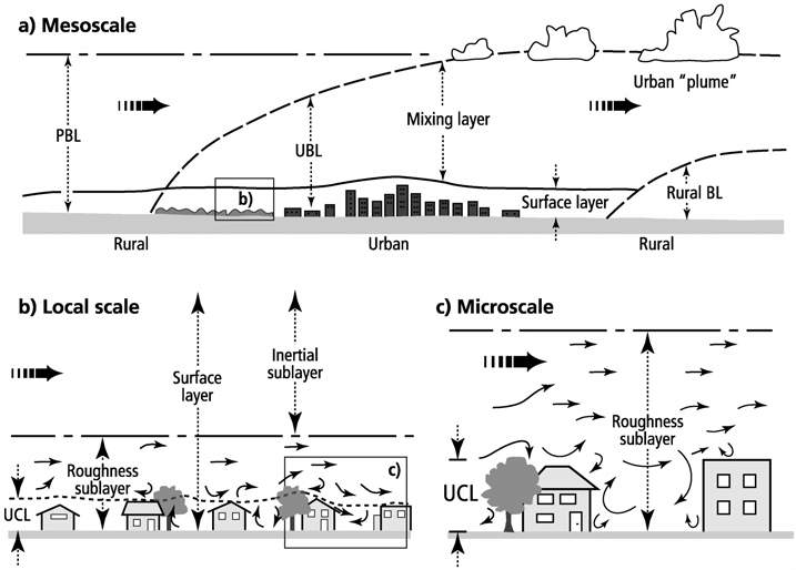

There is often an explanation for readings that seem only a little off. Observations from nearby weather stations and other data sources may not match exactly. Weather stations can be sited differently and some areas subject to microclimate conditions. Instrumentation also varies between weather stations; different sensor manufacturers and styles of instruments have different accuracy specifications and limitations.
Microclimates are localized atmospheric conditions that differ from those in the surrounding area. For example, most airport weather stations read higher temperatures and lower humidity as they are sited over a tarmac surface where the material of the ground is better at radiating into the air above it. These microclimates can be created from ground vegetation and trees, bodies of water, urban areas or terrain influences, etc.
Siting differences can result in different readings too. Some personal, home weather stations may be poorly sited or just experiencing the environment as it is around them. Anemometers can be obstructed from certain directions and subject to turbulent flow around any obstacle in the wind. Temperature and humidity sensors can be affected by moisture in wood decks, dryer vents, radiation from nearby surfaces.
If possible, try moving your Tempest device around and analyze the data - you might be surprised at the varying microclimates around you and how careful siting makes for accurate data.

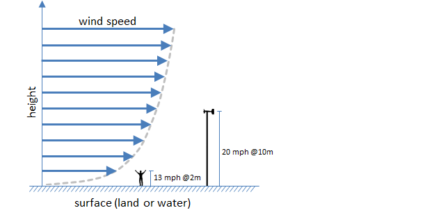

When comparing data from your Tempest to another anemometer, remember that any individual device can only offer an indication of winds at that specific location. Keep in mind that wind speed typically increases with height, and stations in WeatherFlow’s industrial grade network and in NOAA’s observing network generally measure winds at a height of 10 meters or higher above ground level. Winds can also be slowed by obstructions several hundred yards upstream. Professional anemometers are only sited in ideally suited locations with large expanses of clean fetch for winds to accelerate to their full potential (like an airport). Understand that most homes do not have a location suitable for measuring prevailing mesoscale winds. Wind readings from home weather stations will not be comparable to those from professionally sited and installed equipment.
Wind speed is low:
It is common and normal for home weather stations to observe lighter wind speeds in comparison to professionally installed weather stations. This is mainly due to siting and location differences. Most weather apps and news channels report data from weather stations at nearby major airports. These professional installations are mounted at standardized heights 10m (~33ft) above ground, with no obstructions (houses, trees, fences, etc.) in the area to slow or influence the winds. Winds are slower closer to ground due to frictional forces, especially in residential neighborhoods where obstacles create turbulence and disrupt the wind field.
