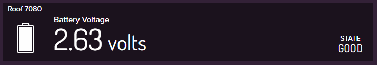

Battery Card Display
You can display a device's battery voltage card in the app. To enable the battery card on the data display, in the app, go to Settings > Stations > (choose a station) > Advanced > tap 'Show Battery Card' > tap Save on the settings menu.
The battery card should then be displayed on the device observations page.
