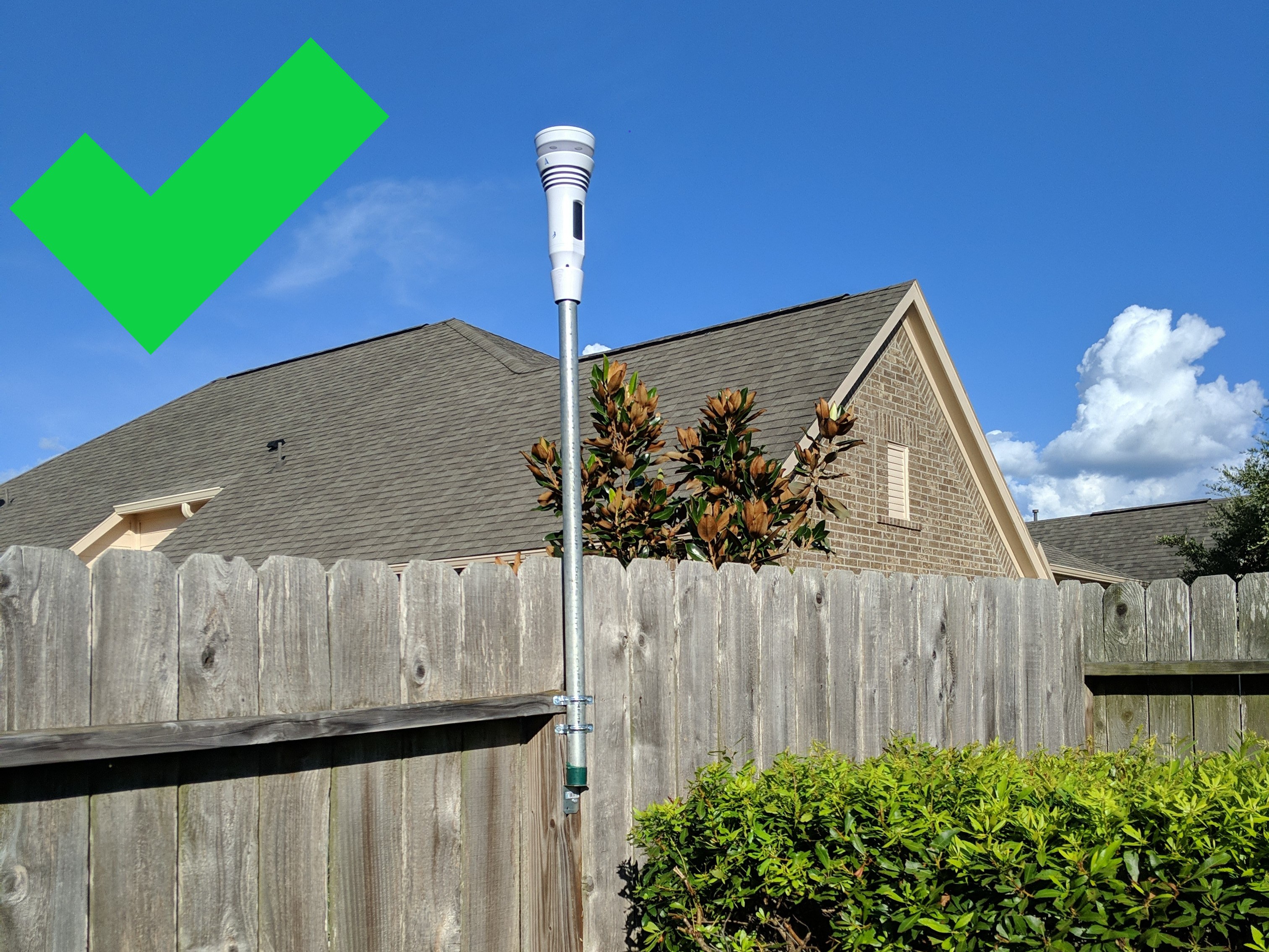

- Choose an open location with good exposure to direct sunlight throughout the day.
- Avoid close proximity to surfaces such as buildings, walls or the ground, while also avoiding any unnatural heat or moisture source such as vents or active chimneys.
- For most owners, the recommended installation is between 6 to 8 feet (1.5-2.5 m) above the ground surface and away from obstacles. Exposure to direct sunlight and an open sky should be prioritized.

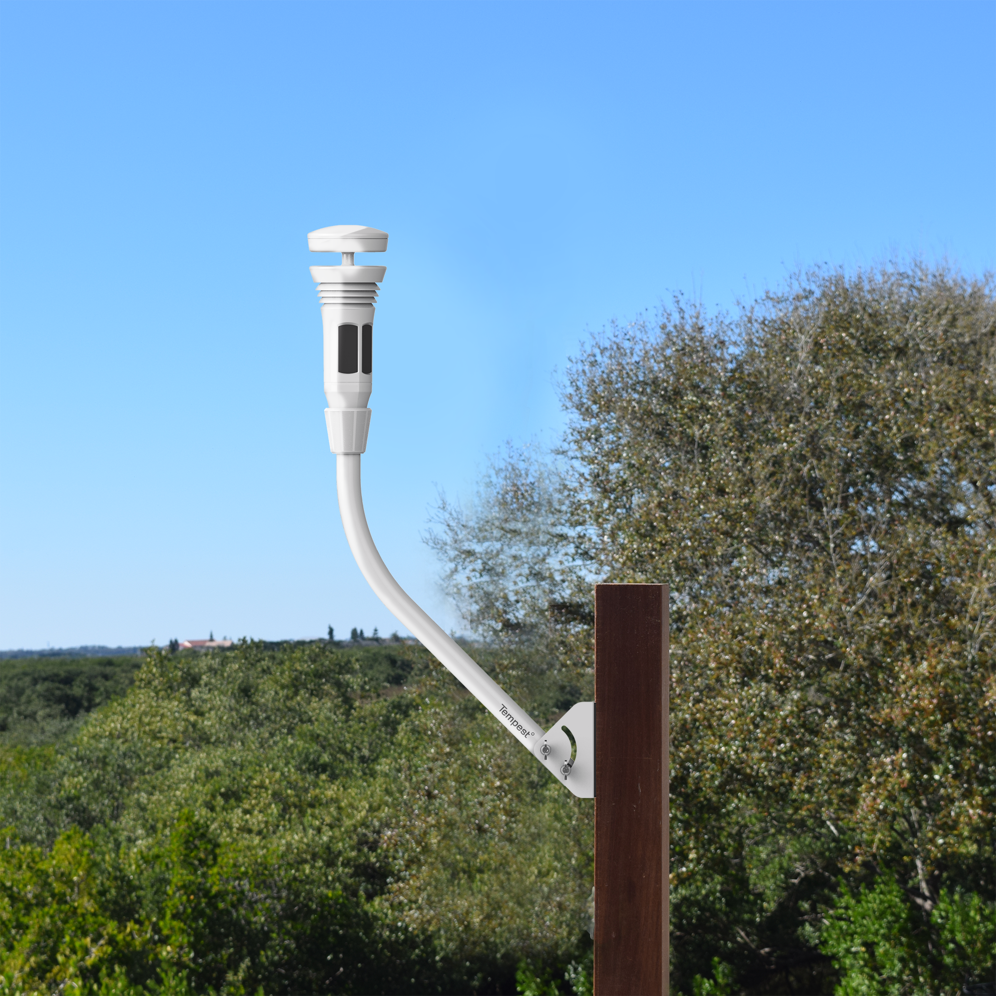

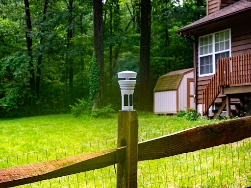

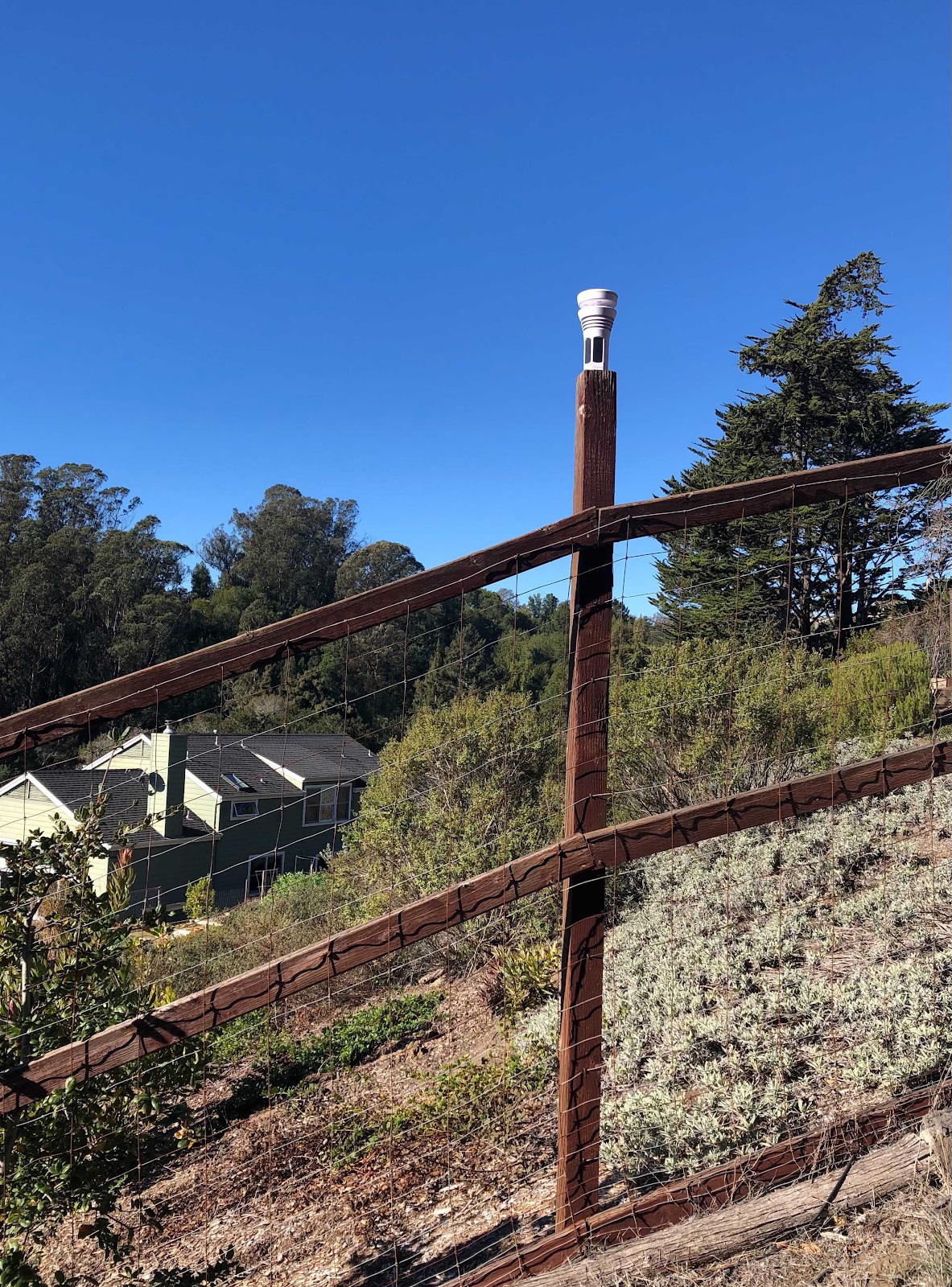

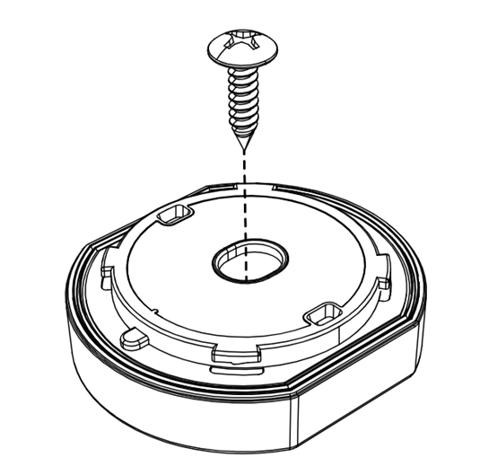

Flat Base Attachment: The easiest installation method is to attach your Tempest on top of a fence, wall, railing, pergola, etc using the flat base and a small wood screw (included). The standard flat base attachment can cinch to a screw head to secure the Tempest device to any flat, level surface. This is the easiest way to temporarily secure the Tempest device. The flat base can also attach to a standard camera mount (¼"-20 threaded bolt) which is more suitable as long term mounting option.
Flat base, wood screw & keyhole slot |
Flat base & ¼-20 camera |
Flat base mount examples
For more detail on the flat base mount, see our step-by-step guide.

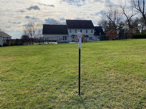

Pole Mount Attachment: Not everyone has access to a surface that allows use of the flat base mount while also siting the Tempest an appropriate distance away from obstacles. You may want to use the included pole mount with a pole. The pole mount attachment is designed to fit a standard 1.25 inch antenna mount or any one-inch nominal pole or pipe (1.315 inch outer diameter) and anything in between.
Pole mount examples
For more detail on the pole mount, see a step-by-step guide.
You can purchase a universal mount (shown above, left) in our online store. Alternatively, schedule 40 PVC pipe is readily available at many hardware stores and is very easy to work with. PVC pipe works quite well for shorter mast length (up to 4 feet) installations attached to existing structures.
For installations using longer mast lengths (greater than 4 feet), such as a pole placed directly in the ground or when you want to get above other obstacles, we recommend using schedule 80 PVC or a metal pole. The 10-foot galvanized steel “top rail” used in chain-link fencing and available at most hardware stores is the perfect diameter for the pole mount. Longer poles require adequate support; either brace them against a structure or bury enough length in the ground.

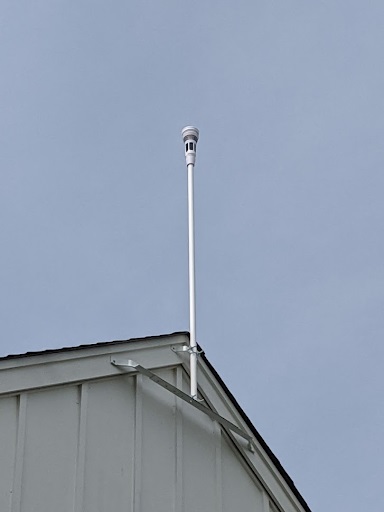

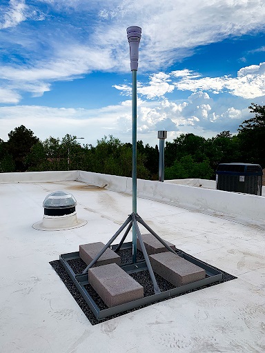

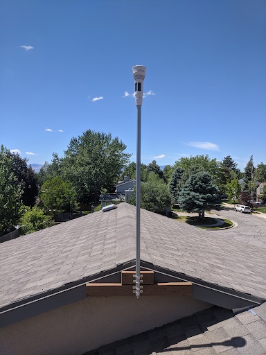

If you do choose to mount on your roof we recommend placing your Tempest at least 3 feet above your peak roof line. Some variation of the following three roof mounting techniques will work for most homes:
Peaked roof & gable mounts

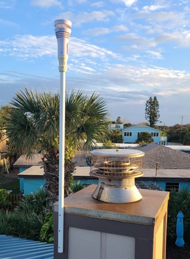

Chimney mounts
Non-penetrating flat roof mounts
