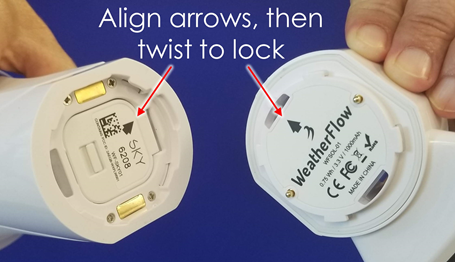

SKY is capable of running off solar power using the solar panel accessory. The solar power accessory is expected to provide 5 years of battery life with an internal lithium iron phosphate battery and up to 30 days of power on a full charge even in full overcast conditions. Low sun angle and minimal daylight hours alone are not an issue to keep the battery charged.
- Make sure there are no batteries in SKY's battery compartment.
- Align the arrows on the base of the SKY and top of the solar panel accordingly.
- Attach the pole mount or flat base mount to the bottom of the solar panel.

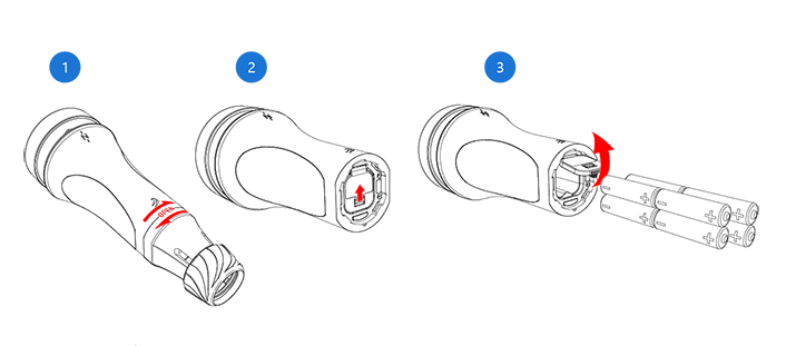

SKY can be powered with eight (8) AA batteries.
Do not attach the solar power accessory if batteries are being used.
- Twist off the pole mount or flat base mount of SKY (if attached).
- Open the battery compartment.
- Slide eight AA batteries into the battery compartment. All batteries in the SKY should face the same direction with the positive ends pointing towards the battery door.
- Close the battery door. The LED/button should light up briefly, then go out.
- Replace the pole mount.

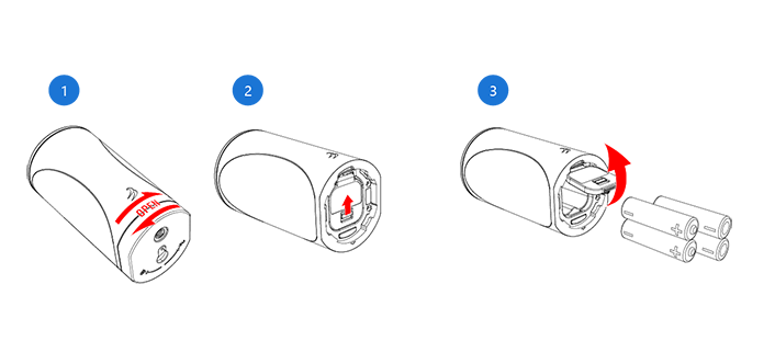

AIR requires four (4) AA batteries.
- Twist off the bottom cover of AIR.
- Slide four AA batteries into the battery compartment. Make sure the batteries are inserted in the correct direction with the negative end touching the springs.
- Replace the bottom cover by aligning the grooves and twisting clockwise until the base locks into place.

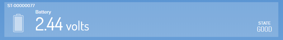

Battery Level Indicator
You can check the battery level for your device by viewing the status page for your station: In the app, go to Settings > Stations > (choose a station) > Status
Battery Card Display
You can display a device's battery voltage in the app. To enable a battery card indicator on the data display, go to Settings > Stations > (choose a station) > Advanced > toggle Enable Battery Card
